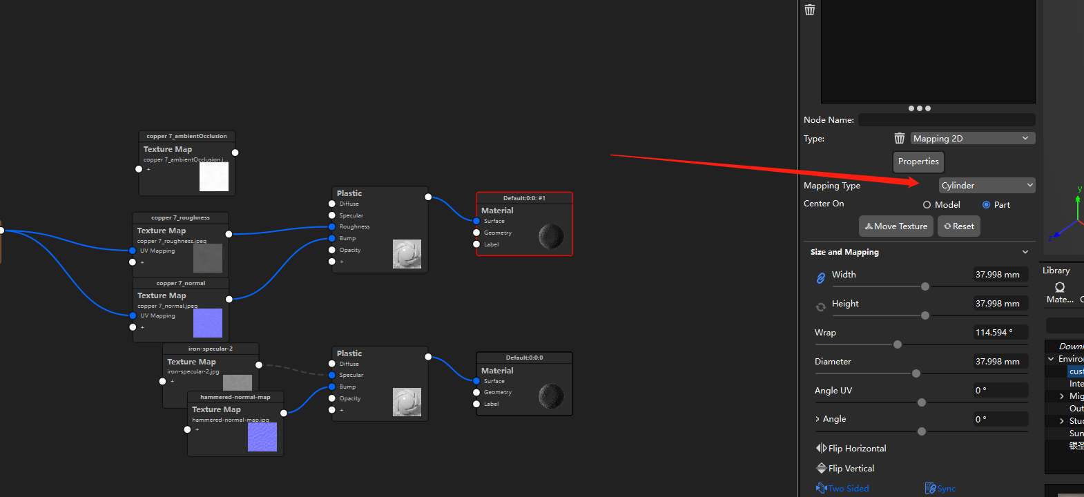

What's wrong with the cylinder mode

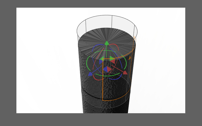

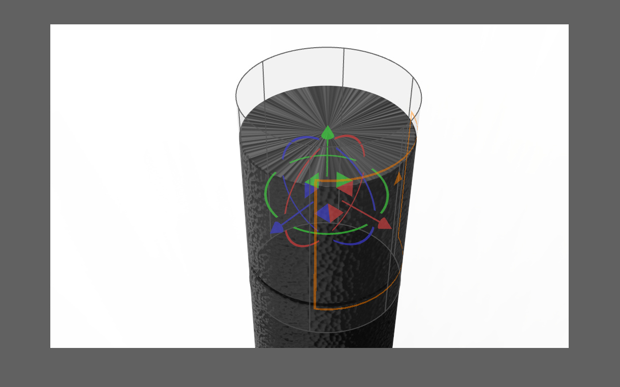

I chose the cylinder mode but it turned out to be like image 01, anyone knows what 's wrong with this

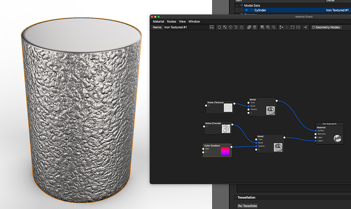

Nothing is wrong. You just need to limit texture from occurring at the top. This can be done by splitting surfaces (if the hard edge isn’t a problem) or by gradient applied to side texture opacity.
